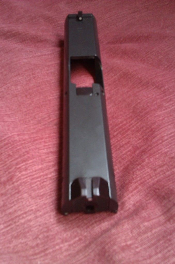

The slide is metal, some steel version, and is very well made and finished in metal form (except the extarnal Plasox). It houses the striker assembly, rear sights, extractor etc. Frame, is polymer, which I believe could do with slight improvement in toughness in future generations/models. While it is very durable, apparently, one can see that it is not difficult to deform its surface contours. It will last many a thousands rounds, but the surface hardness could be a bit higher.
The slide slides outside the frame. The frame houses a complete steel sub-frame, which contains the trigger group. This, in my view, is a very solid construction philosophy. The major weight reduction is achieved by a polymer frame, while the strength is achieved with having an independent steel internal housing, which bears the load of cycling during recoil etc. There are still only 4 contact points (2 pairs, front are rear), 2 in front of the trigger group, and 2 at the rear. This is similar to the P07 Duty, but in the P07 Duty, the contact points are attached independent of each other via pins for each group in the frame. The sear cage, trigger group, hammer, are also all 'pinned' to the frame, and not a sub steel assemble. Further, the thickness of the slide rails in the frame is more in the Caracal C. While this may not give any engineering benefit, it is psychologically reassuring. They could add some coverings to the internal parts of the slide, though. While the exposed springs etc do no harm, they do not particularly look urban either, and give a rustic feeling.

I had no desire for the QS (quick sights) model, and opted for the normal sight model. I would prefer night sights, but the straight eight on the Caracal would do otherwise. However, the rear sight is machined into, and a part of the slide. It is not fit in a dovetail etc. This can be solved by grinding and milling out this rear sight, and cutting in a new dovetail of ones liking. However, proper calculation for elevation would have to be made, otherwise it would be difficult to find a matching front sight. If done properly, one could simply cut in a Glock dovetail, and install Glock night sights.
